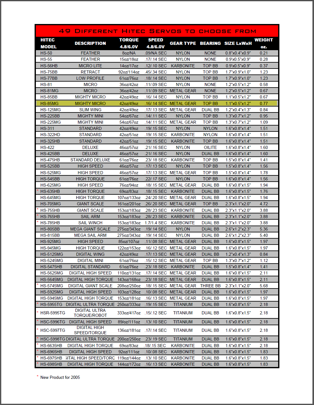

Unread post by steve » Sun Aug 07, 2011 11:58 pm
I've highlighted the one that seems the most popular by the other owners of this plane. I am not familiar with this plane personally myself other than seeing yours but this chart should help you
Good luck !

Hitec servos are the big seller...and the HS85's with metal gears that Steve points are a good choice.
