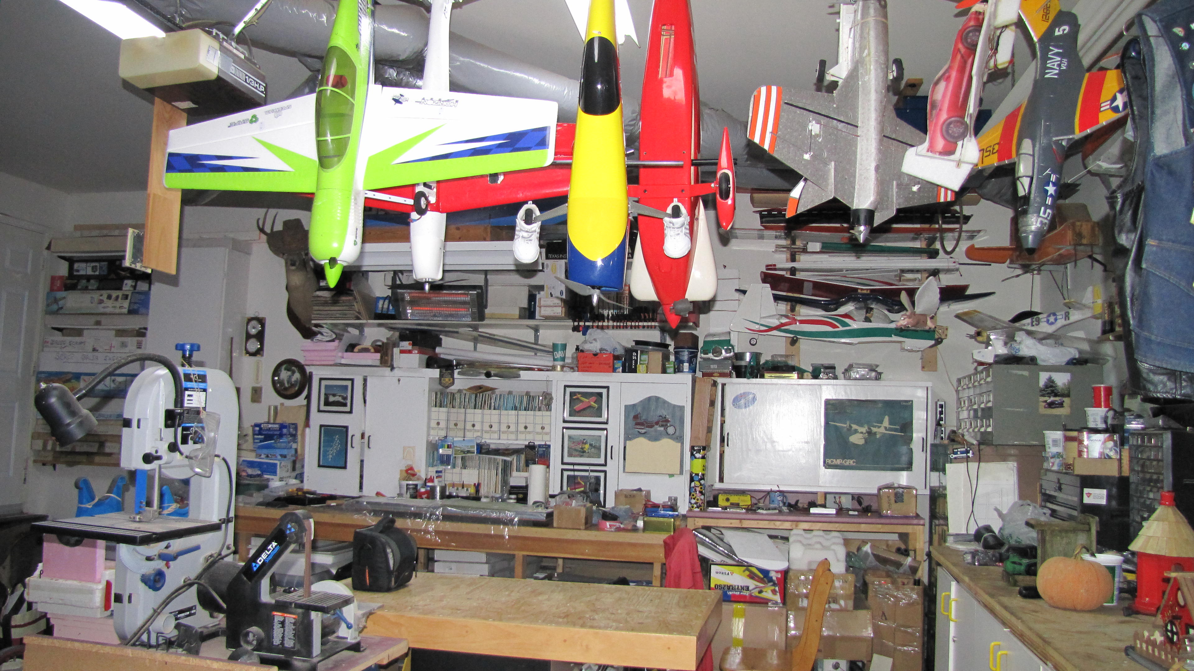

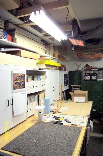

I've been asked for some ideas on a workbench, so thought I would start a thread with a few pics of what has worked for me.
I built my workbench in 2002, my second year of retirement, and knew from past modelling days in the 1980's that an eight foot long table is a good length, but if you keep it four feet wide, and plan to have any cabinets at the rear, you wanna have very long arms..! For that reason I reduced the width (depth) of this one to 42 inches, and I still have to lean to reach those cabinets but it works nicely for me.
I built a 2x4 frame and used TWO layers on the top. First was a reasonably cheap 3/4" thick particle board sheet, then a more durable 3/4" thick "good one side" plywood sheet. I screwed the top sheet to the lower sheet from underneath. I faced the front and sides with a four inch wide by 1/2" thick pine facing and finally edged the pine with a 1.5 inch by 3/4 inch oak trim. Seems like a lot, now that I put it in words but you know how it is....you only want to build it once, so let's try and get it right. The reason for the oak, and I got this idea from a model mag, is that when your sanding an item close to the edge of the bench, you want a hard surface in case you sanding goes astray and you wind up sanding the bench...something like that..!
Bottom line is that I have been very satisfied with this setup for six years now. A good sanding job and a few coats of Varathane and this bench was ready to go. The pictures taken in '02 show it as it will never be seen again.....pristine and empty. Boy, it's hard to keep it that way. I guess a crowded bench means you're still having fun!
I have read articles where the builder has made an elaborate setup in order to KEEP the top of the bench level in all directions and I quickly realized that this was not for me. So I built it as close to level as a four foot level would get me and then built a separate building board, roughly 42" by 9" that I know is flat, and which I can pin balsa to if it's necessary when building a wing, etc. (I posted a separate thread on the building board) Actually with some of the newer laser cut kits and fancy "truss" design, some models can now be built true and straight without being pinned down.

Behind the bench and centered between the cabinets is my collection of RCM magazines from 1975 to the early 90's. For ten years I had every issue, then they get a bit sparce. Nowadays it's FLY R/C that I've subscribed to for four years and even recently won another year to, for submitting an idea for attaching a windscreen. I liked the plans they would publish every quarter but I see they are getting slack on this.

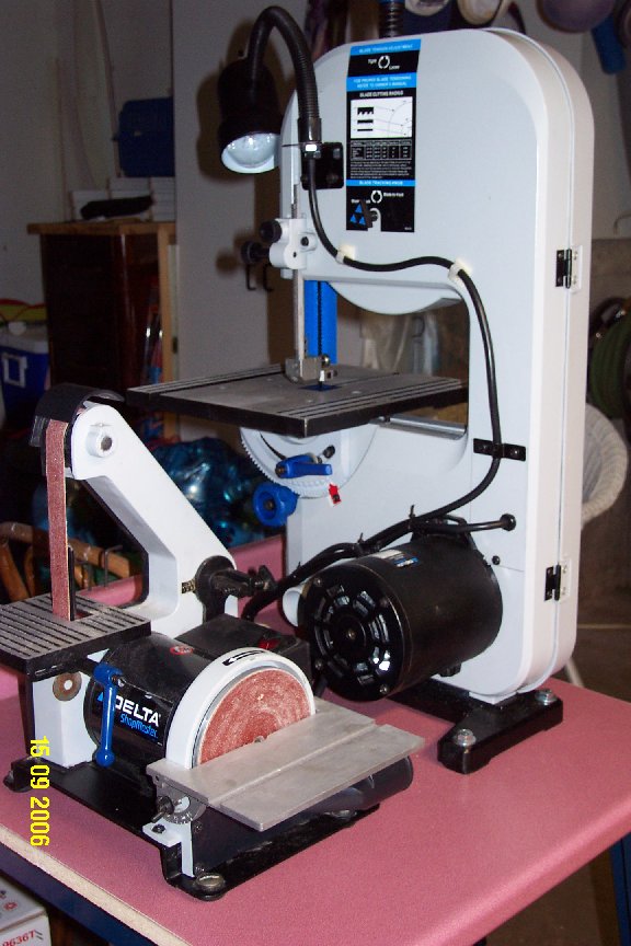

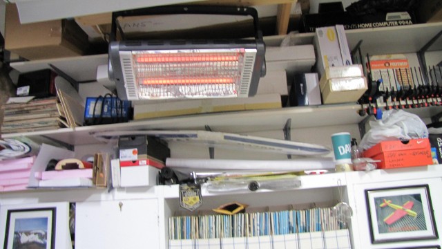

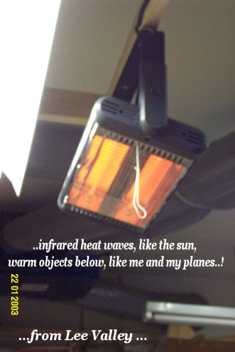

Couple of items that have really worked for me are an Overhead Radiant Heater...and a 9 inch Bandsaw and Belt/Disc Sander combo.
Since my bench/workshop is in my "garage" and even though there is a 10 foot electric baseboard heater unit under the bench I don't use it as the cost of operation would probably cut heavily into my model budget..!
Instead I mounted a radiant heater, ABOVE the bench, and it does a great job of heating the entire surface of the bench and all objects on the bench and I wind up wearing a hat to keep my balding head from overheating!

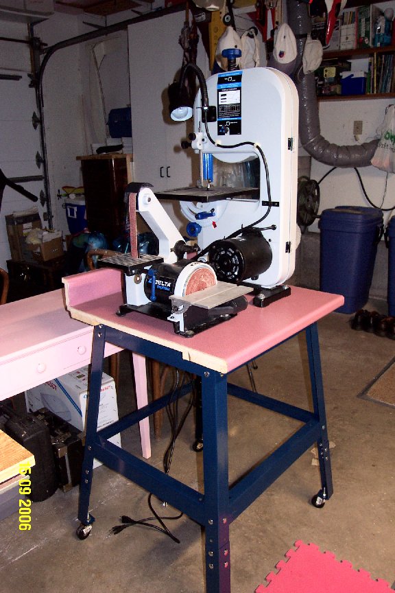

For awhile I used a scroll saw for cutting out ply pieces, etc, but switched two years ago to a DeWalt 9" bandsaw and I find it much better. I mounted it on a surplus piece of countertop and supported it with a $20. frame from Canadain Tire that is on casters. If I'm doing a big job, I open the door and take it outdoors. Mounting a small belt/disc sander alongside the saw completes the setup and you can quickly cut a piece and have it sanded and ready for installation.
The last thing I did was drop mount an electrical box, three feet down from my ceiling mounted garage door opener box, so now I can plug in my mobile saw/sander right above where it sits. I always say ..."you gotta have the gear!"

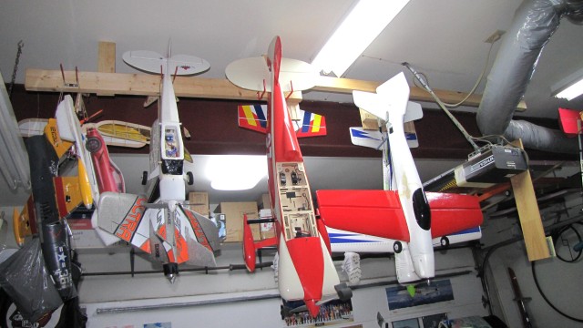

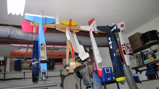

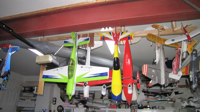

I've been asked lately how I hang up my models, and also have posted that those radiant heaters are now on sale at Princess Auto this week for just $48.88 instead of $69.00

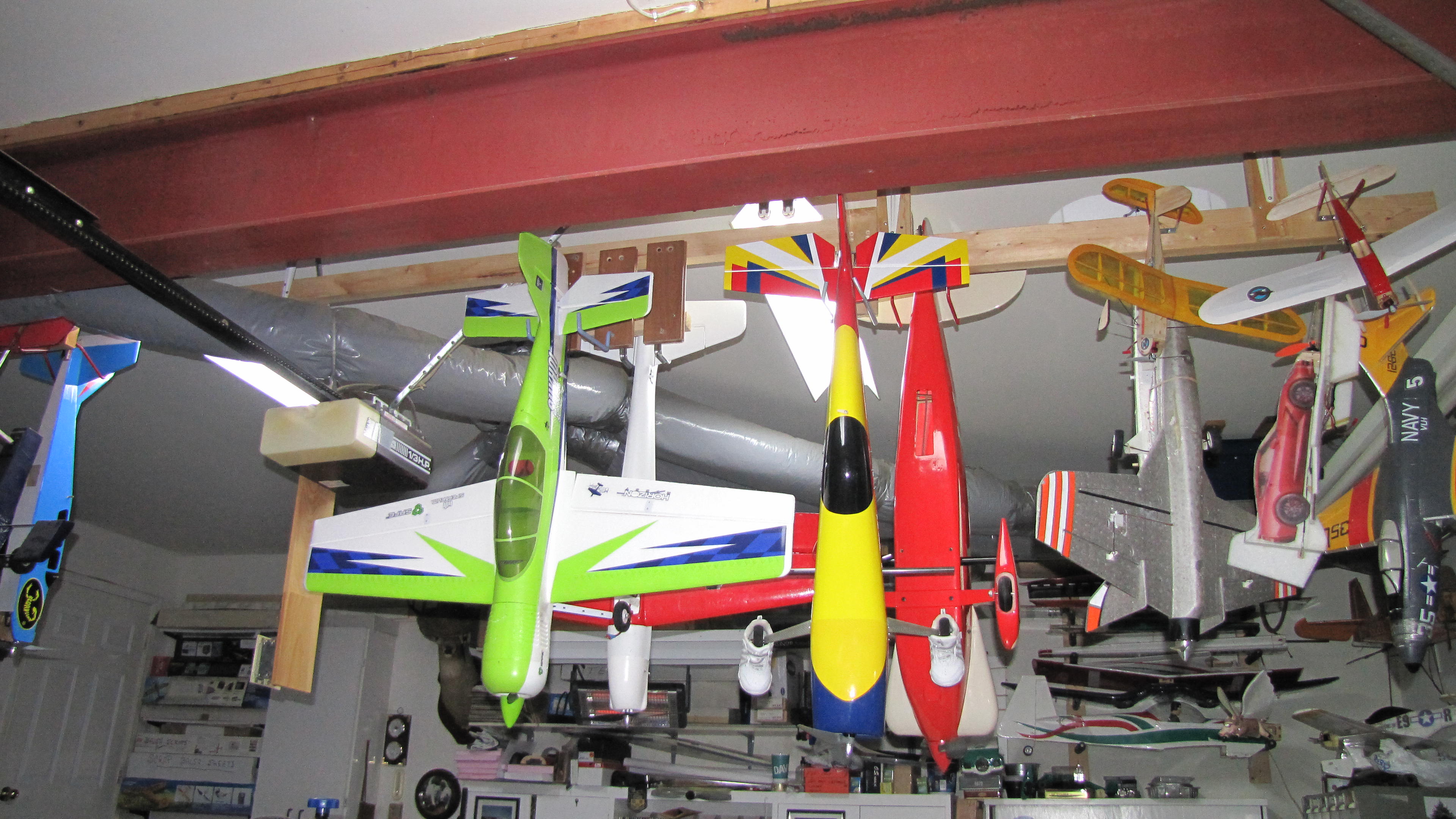

So here are a couple pics of my stuff hanging from the horizontal stabs....works quite well with a nine foot ceiling. Otherwise hang them from a wall so they don't get bumped.

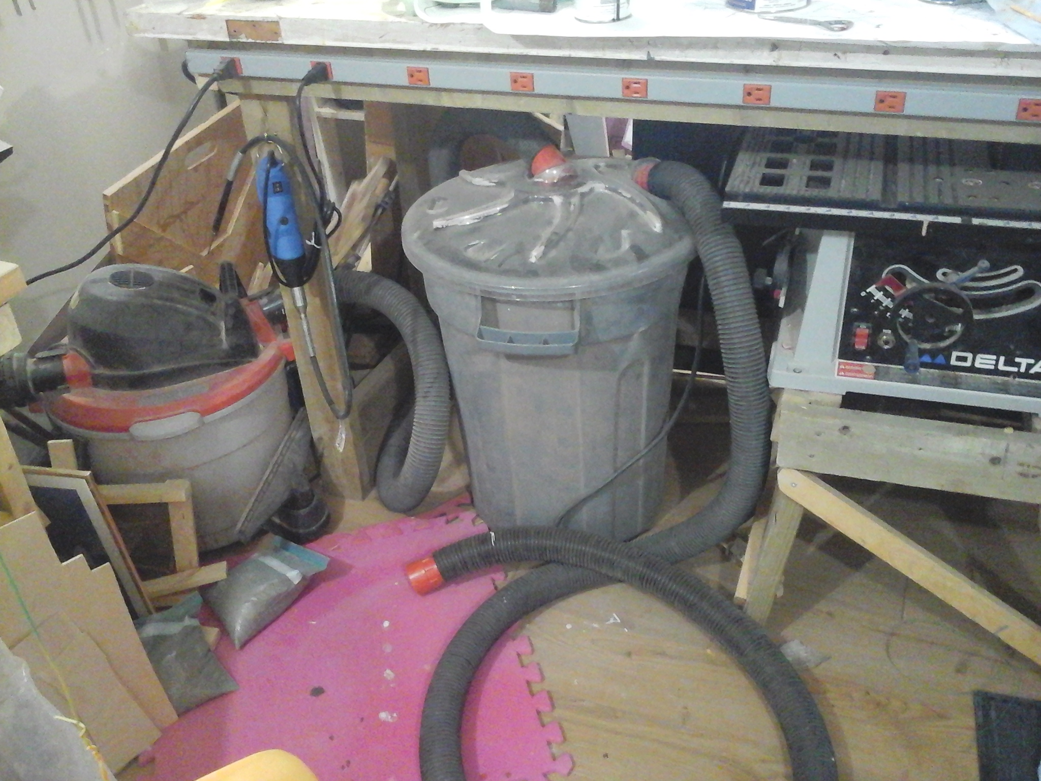

For 'indoor' shops having a shop vac is a must once you start sanding. I have a long hose and some gates that i setup at workstations for quick use.
A few years back my wife got me a Turbo-lid. It sits over a garbage can and connected to the shopvac. Don't have to worry about cleaning out the shopvac.
